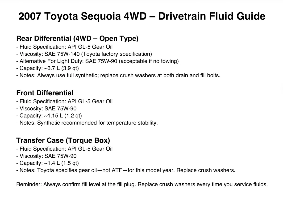

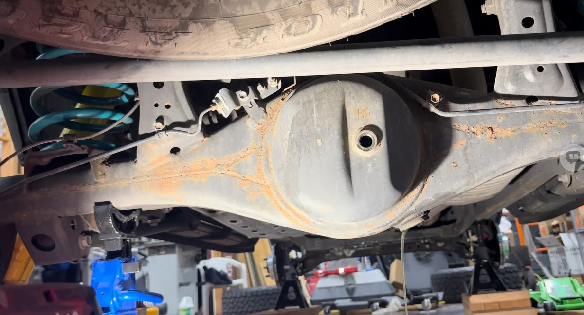

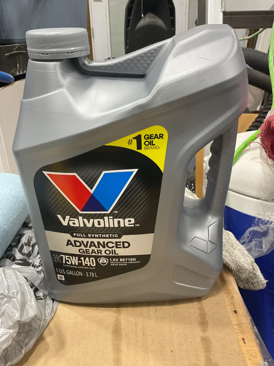

My 2007 Sequoia 4WD Limited called for 75W140 gear oil, and I used Valvoline full synthetic when changing out fluids. I created a maintenance manual for my vehicle using several AI tools. I also removed the rust on my rear axle and repainted the rear differential.
  • Sequoia_Drivetrain_Fluid_Guide.pdf
