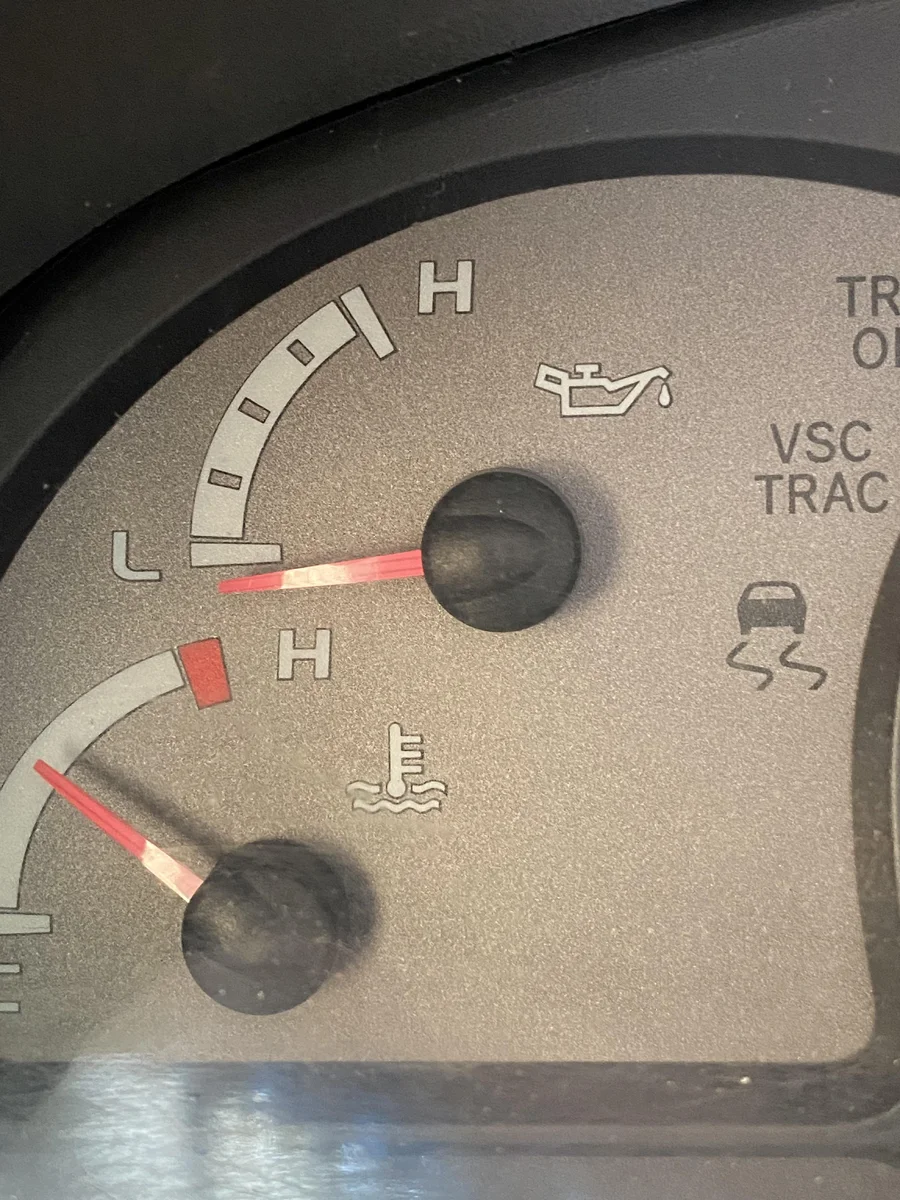

I need to find the site where this gremlin is well documented. It's NOT oil pressure, it's the oil Gauge. Pressure gauge varies all over the place including zero. I replaced the sender We've driven it thousands of miles and if the oil pressure went to zero it would last only seconds before the engine blew.

This is what it looks like

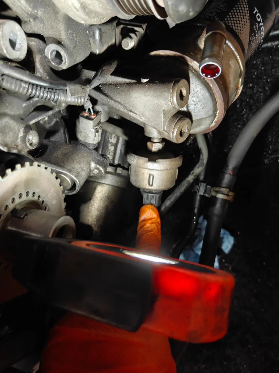

This is the oil sender, located on the back of the oil filter housing, left front lower of the engine. Pull the connector and ensure there's not a bunch of oil in the connector itself. Typically oil in the plug won't stop it from working but contamination can sometimes cause issues.

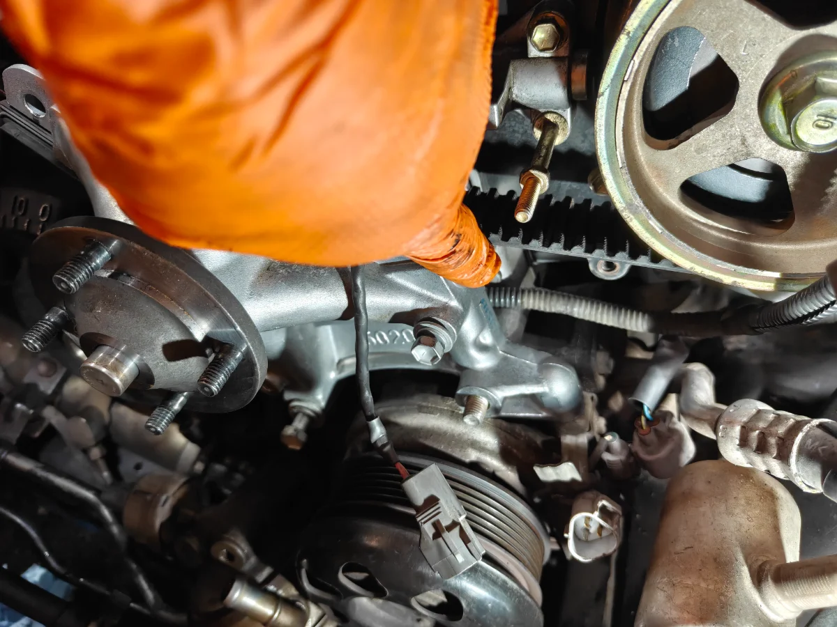

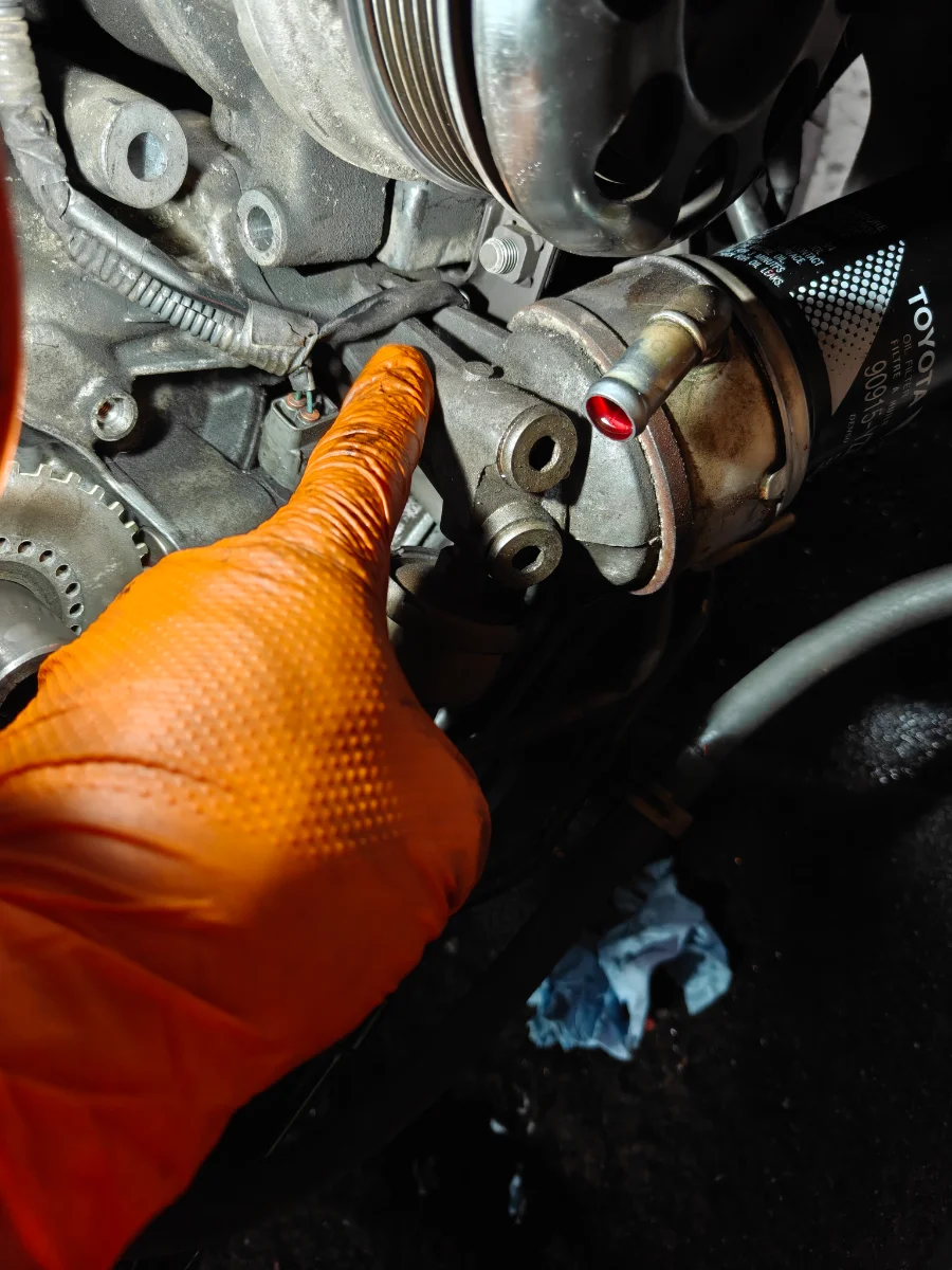

The harness wraps around the bottom of the oil filter adapter housing and comes up here. The wire being bent around that area could cause a wire to fail internally or the wire to break externally.

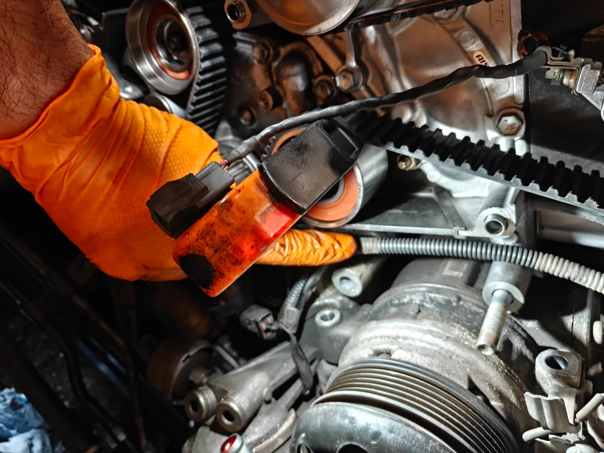

Something that is not uncommon is when the timing belt is done, people will route this wiring harness around the outside of the fan pulley bracket which A. Can cause the wiring in the previous picture to stretch or remain under strain and B. If not properly secured it could come in contact with the serpentine belt between the upper idler and A/C pulley.
Proper routing is under the fan bracket but re routing it after the fact is kind of a PITA. It is suppose to be here: (LH cam pulley cover removed in picture)
