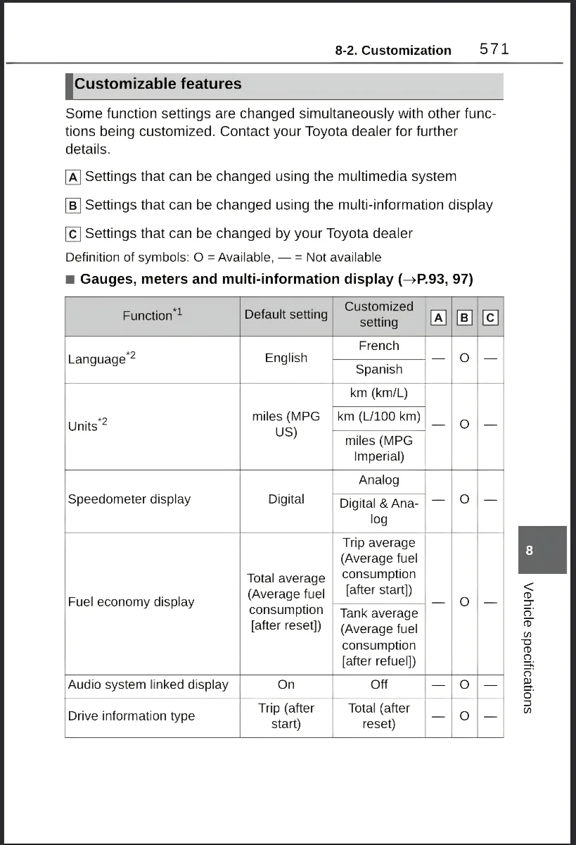

I've noticed that the MPG counter will drop dramatically if I sit idle. That brings the overall average down. I switched my instrument cluster eco tab to "tank average" versus overall. Gives me a better signal to learn how much my driving style affects the counter. I average around 18-20.

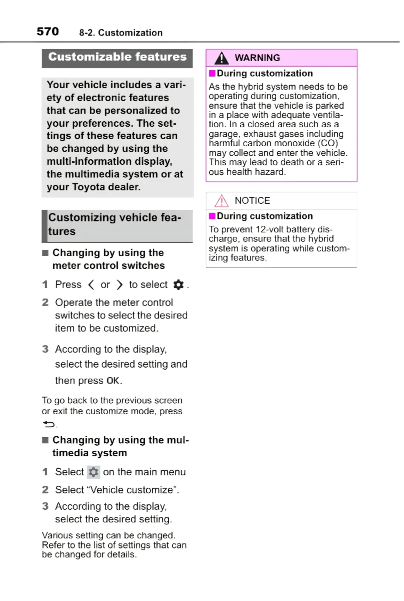

Thanks so much for your reply. Our mileage is showing total overall. I’m having trouble finding where you change it in the settings to ā€œtank averageā€. I’m not very tech savvy is part of the problem.
