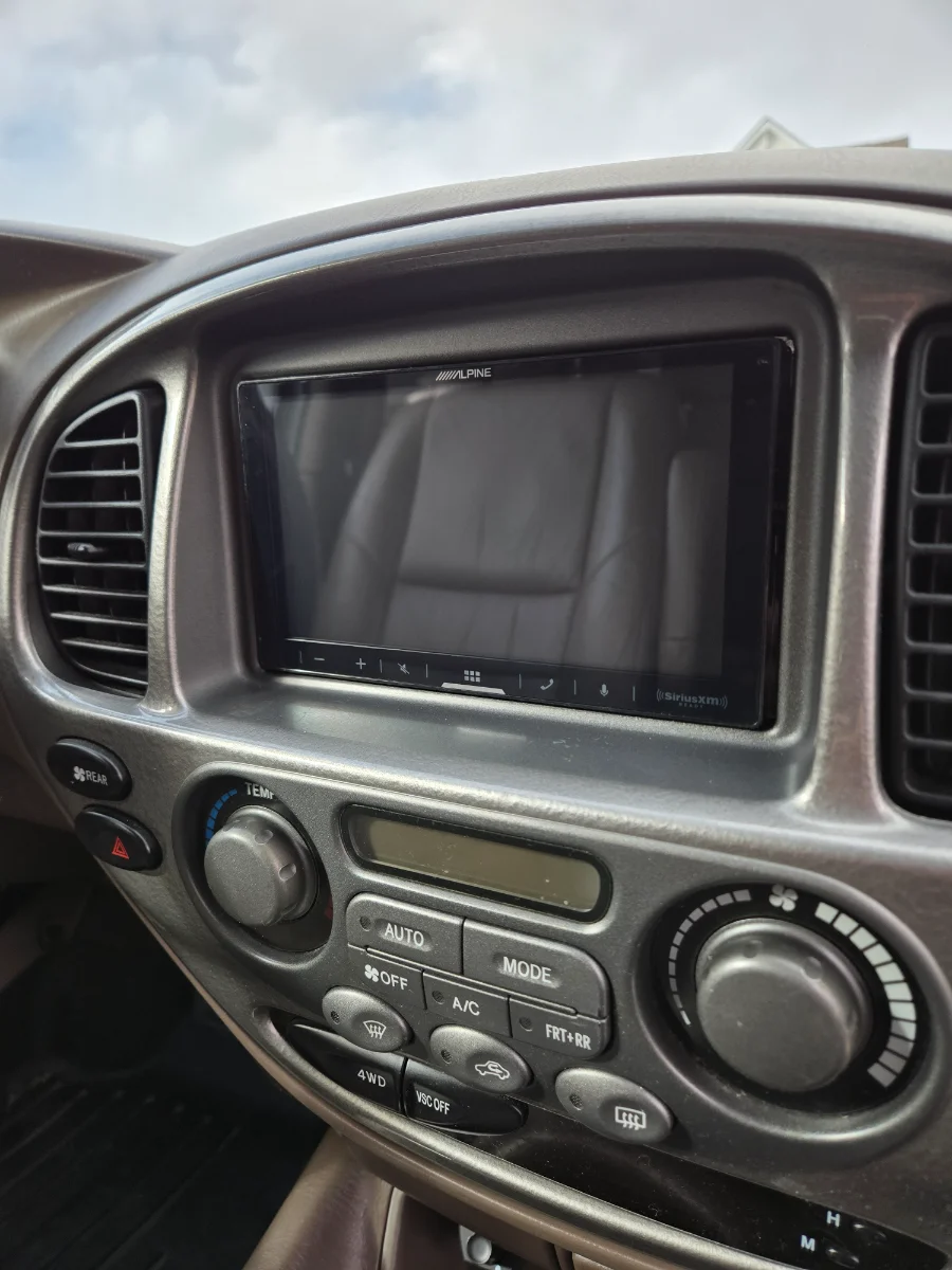

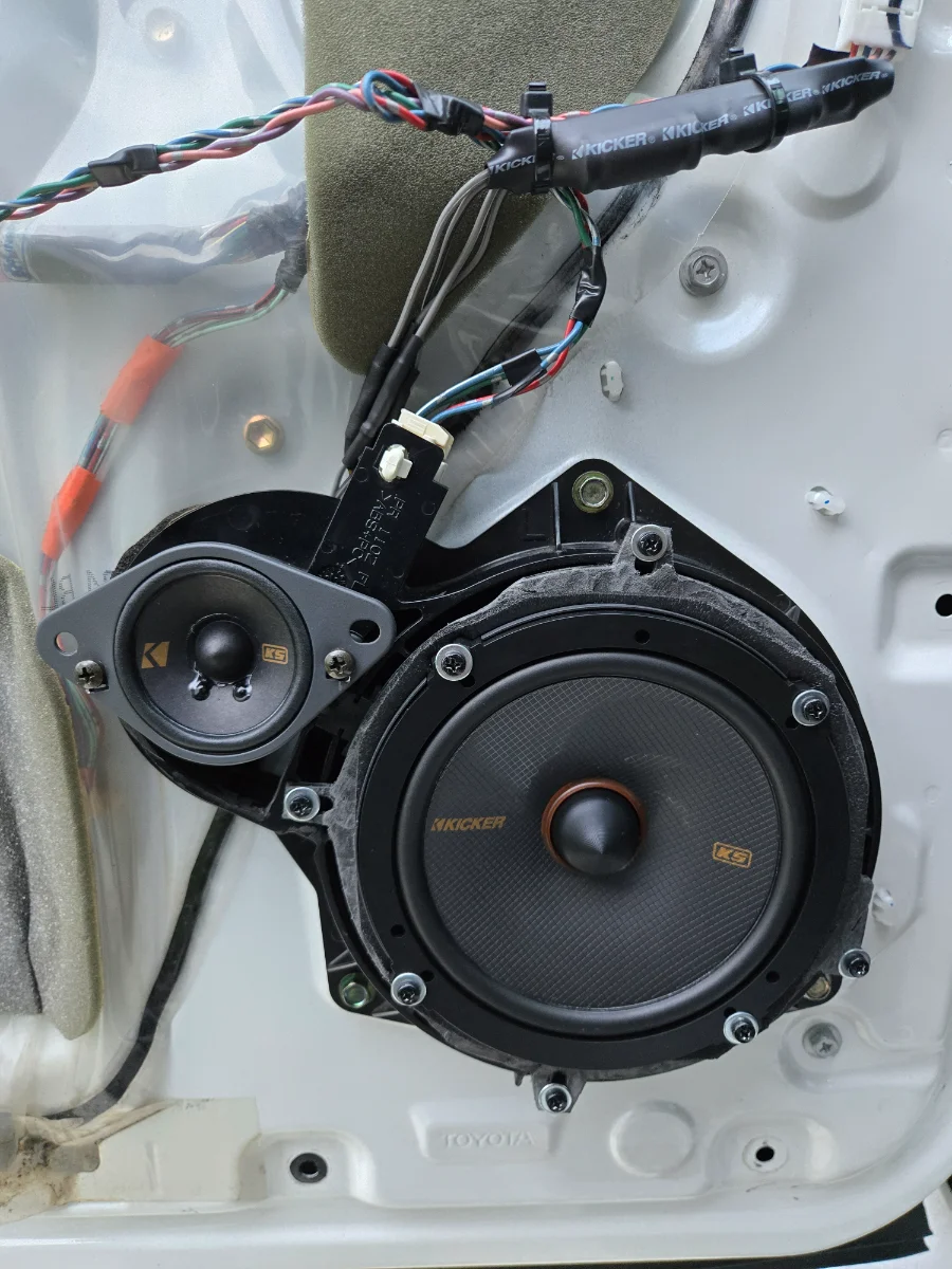

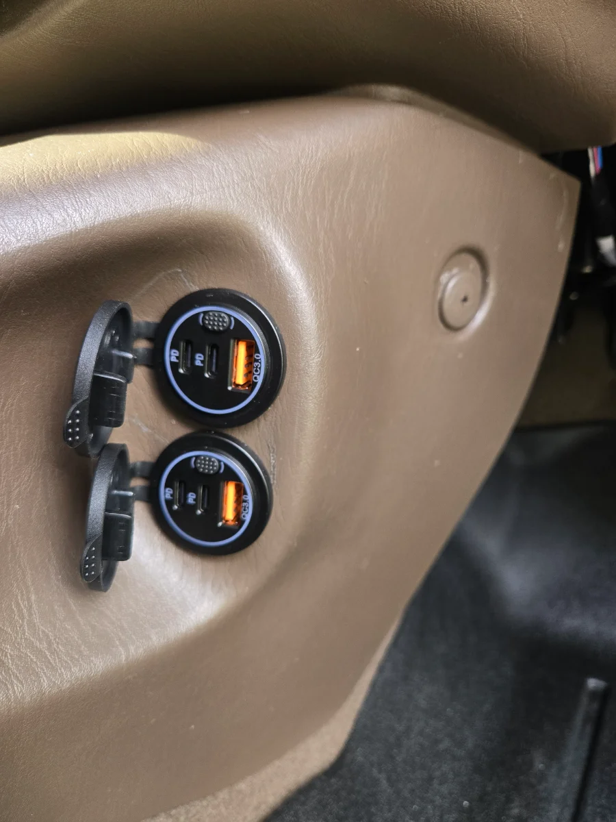

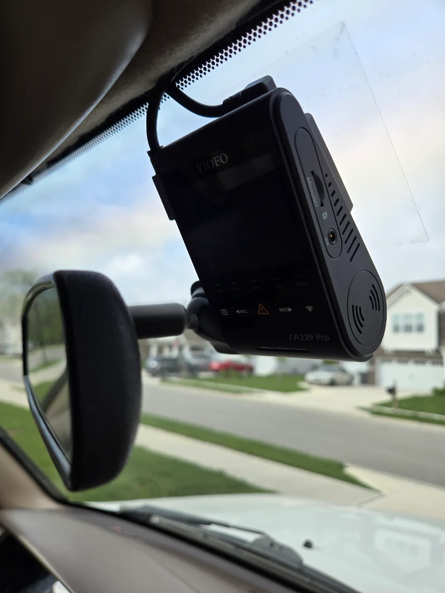

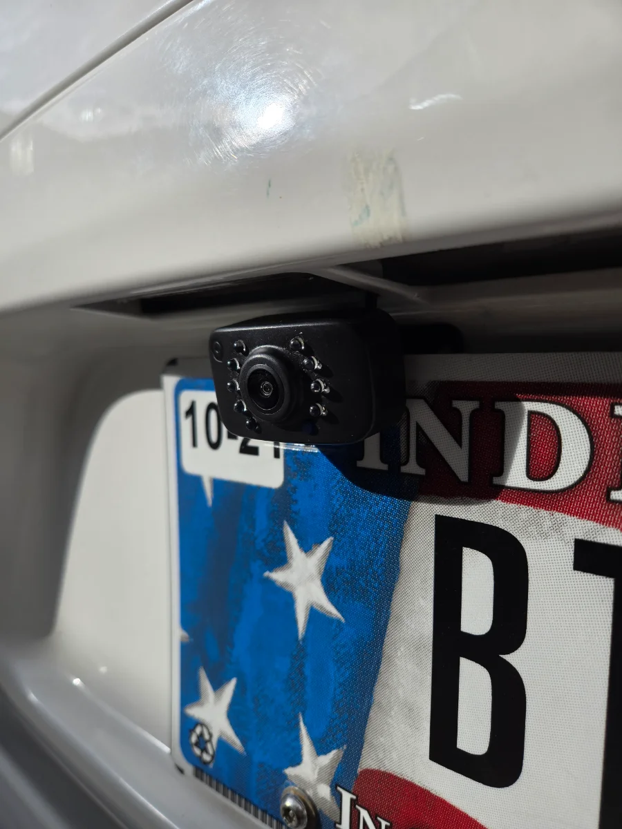

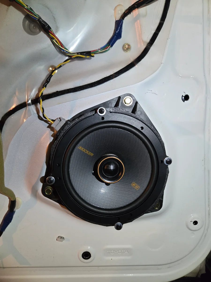

I've been slowly upgrading over the last year on my 2001 Limited 4wd:
Suspension (upper and lower ball joints, inner and outer tie rods, front struts, 2" front lift pucks (was 3", rear already 3"), poly sway bushings, poly steering rack bushings, 1" front diff drop)
Stereo, speakers, and video:
Kicker KSS365 (front doors) and KS 6.5 peakers (rear doors) Alpine touchscreen radio and matching Alpine powerpack amp (50 watts x 4 channels), charge ports (6 of them--2 front, 1 lower rear center console, 2 for 3rd row, 1 for rear storage area), back-up and front camera, and front and rear dash cams. While there is some complexity to the install (bypassing factory JBL amps, repinning wire harnesses, fishing wires thru rear hatch, etc), if you use YouTube and AI searches, you can find all the details to do the install. Below are links to parts installed and install videos I found helpful.
Kicker KSS365 KS Series 6-1/2" 3-way component speaker system at Crutchfield https://share.google/r6wWNXRUfuxZnNTga
Kicker 51KSC6504 KS Series 6-1/2" 2-way car speakers at Crutchfield https://share.google/loyBCkaeRmgWTTxwo
Alpine iLX-W770-M Digital multimedia receiver (does not play discs) at Crutchfield https://share.google/FJ7RaCcXGlUnOn3LR
Alpine KTA-450 Power Pack Compact 4-channel car amplifier — 50 watts RMS x 4 at Crutchfield https://share.google/O6pyOhfcpe2xTu7oe
Kicker 46CXA400.1T CX Series mono subwoofer amplifier — 400 watts RMS x 1 at 1 ohm at Crutchfield https://share.google/sVVdDJVTE5BB2dKIl
Kicker 50CVX104 CompVX Series 10" subwoofer with dual 4-ohm voice coils at Crutchfield https://share.google/5ZSF70RLPhmsmfBJj
