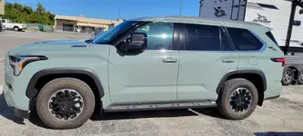

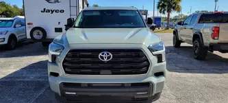

Hi - has anybody tried to replace their SR5 or Limited model of 2023 Sequoia's fenders with the digital camo pattern fender flares (with marker lights) of the TRD Pro trim?
Also, does any TRD Pro owner know the Toyota part numbers of all the fender flares on their vehicle?
I've been trying to get the exact part numbers for the '23 Sequoia TRD Pro flares, but the Toyota Information System at the dealer keeps coming up with Tundra TRD Pro flare part numbers (even after providing VIN numbers of TRD Pro vehicles).

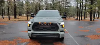

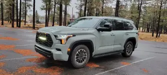

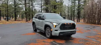

Got the following mods installed on 2023 Sequoia SR5:
- TRD Pro Front Grille (with Light Bar and 3 Marker Lights)
- TRD Pro camo pattern fender flares (with marker lights) for the 4 wheels
- TRD Pro Skid Plate with red TRD lettering (not clearly visible in these photos)
- aFe Front Tow Hooks (red)
- Removed the air dam (valance) from the front of the vehicle.
