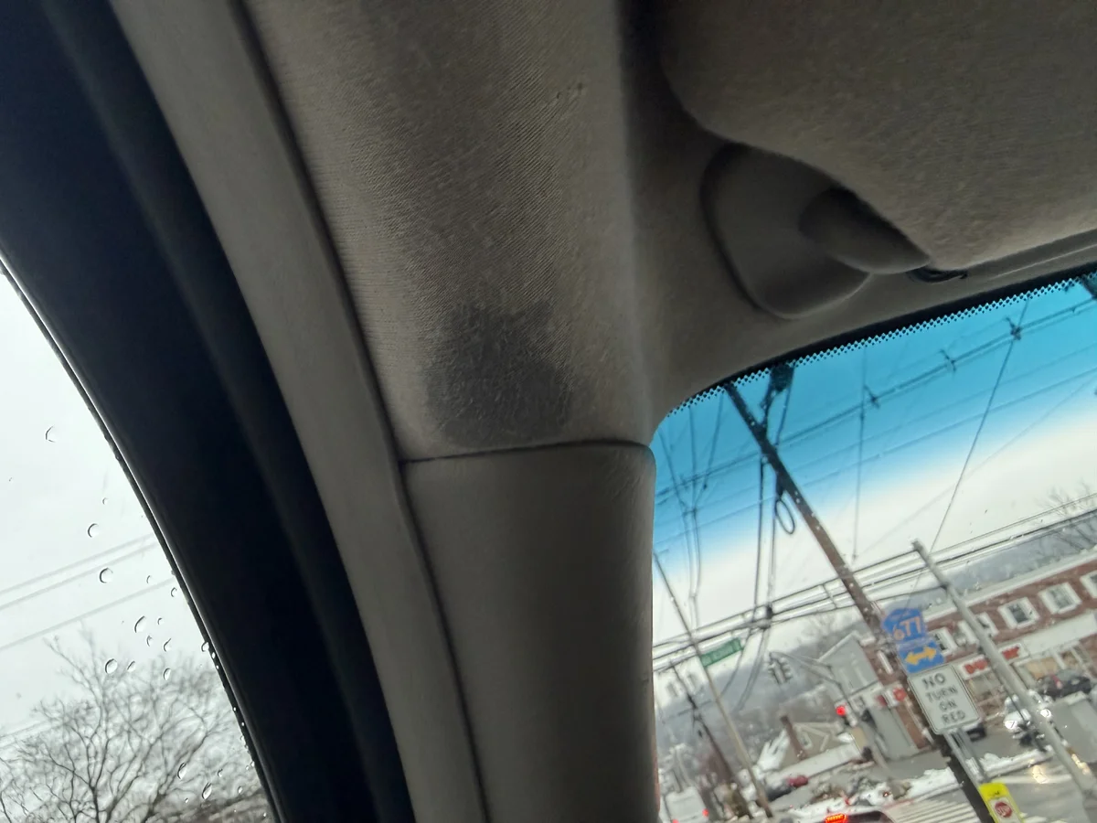

Hi all I have an 2005 sequoia with water intrusion on both sides of “ A “ pillar same spots both sides. any help on it ? I checked sunroof drains they’re draining perfectly fine.
Hi all I have an 2005 sequoia with water intrusion on both sides of “ A “ pillar same spots both sides. any help on it ? I checked sunroof drains they’re draining perfectly fine. View attachment 609
I’ve read on other forums the mounting bolts for the roof rack can leak as well. Water might be leaking in and traveling down towards the front of the vehicle and showing up at the top of the A-pillar. Worth a look.
Thanks for the input I’ll def have a look at that
