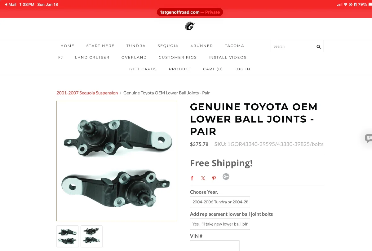

Fairly easy to replace. I was able to swap out lower ball joints with new OEM parts from 1stgenoffroad.com for much less than dealership prices, and includes new bolts. Josh has been very good with assistance, as I also upgraded and lifted my 2007 Sequoia.

This is a safety issue. If it breaks while you're driving, you not only risk damaging many parts of your vehicle, you can wreck it. There are several videos of this. I recommend replacing the parts immediately with OEM parts because there many posts saying the aftermarket parts may only last 10K miles or less.
Be sure to get your parts from a supplier who uses your VIN to identify the year and MONTH of your Sequoia's birthday because Toyota made some changes mid-year within the same generations.
