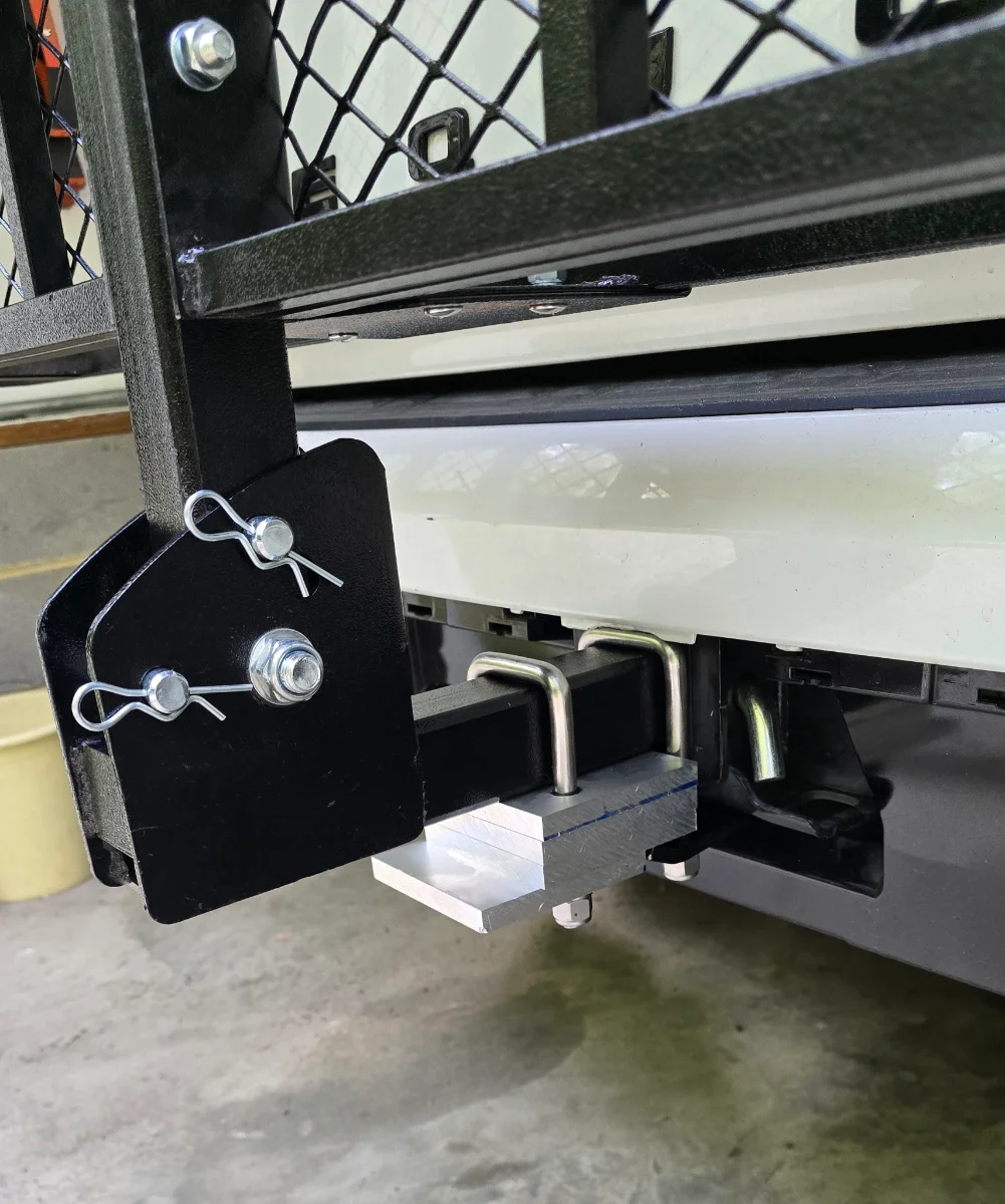

Thanks for the reply. See attached picture showing how we made the hitch stabilizer work. We had to make up the 1 1/2” gap caused by the hitch design. The carrier remained solid after our recent 300 mile trip.

Looks very solid thanks for sharing
