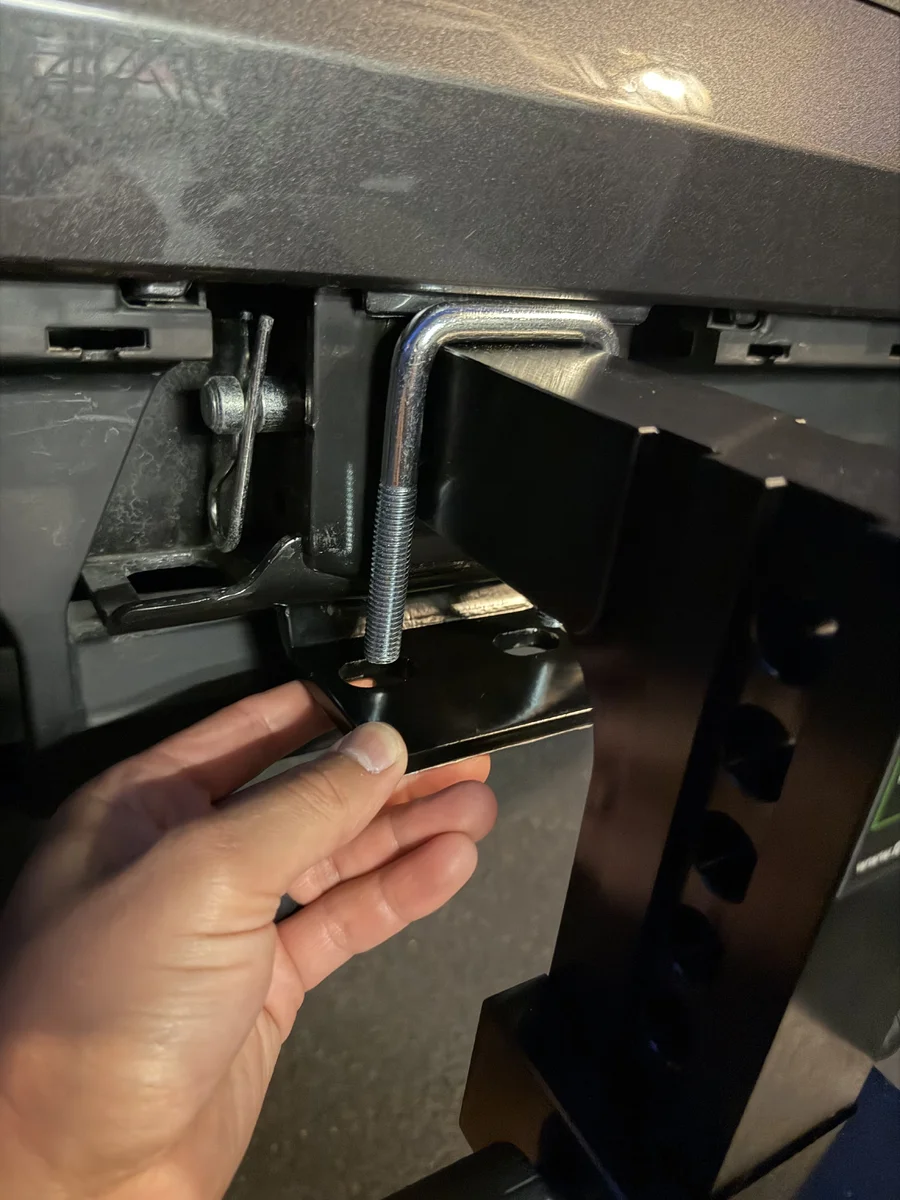

Anyone have links to the absolute best stabilizers for these 3rd gen sequoias.. all that towing power just to be left scratching your head on the day of the tow haha.

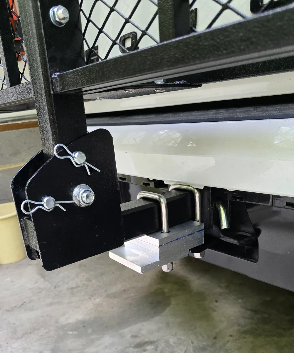

We had to get longer Ubolts and make up the 1 1/2” gap caused by the hitch design using 4x4x1/2” aluminum plates.

Thank you.. I purchased 2 things off Amazon. I’m no on a give those a shot and follow or go this route.
