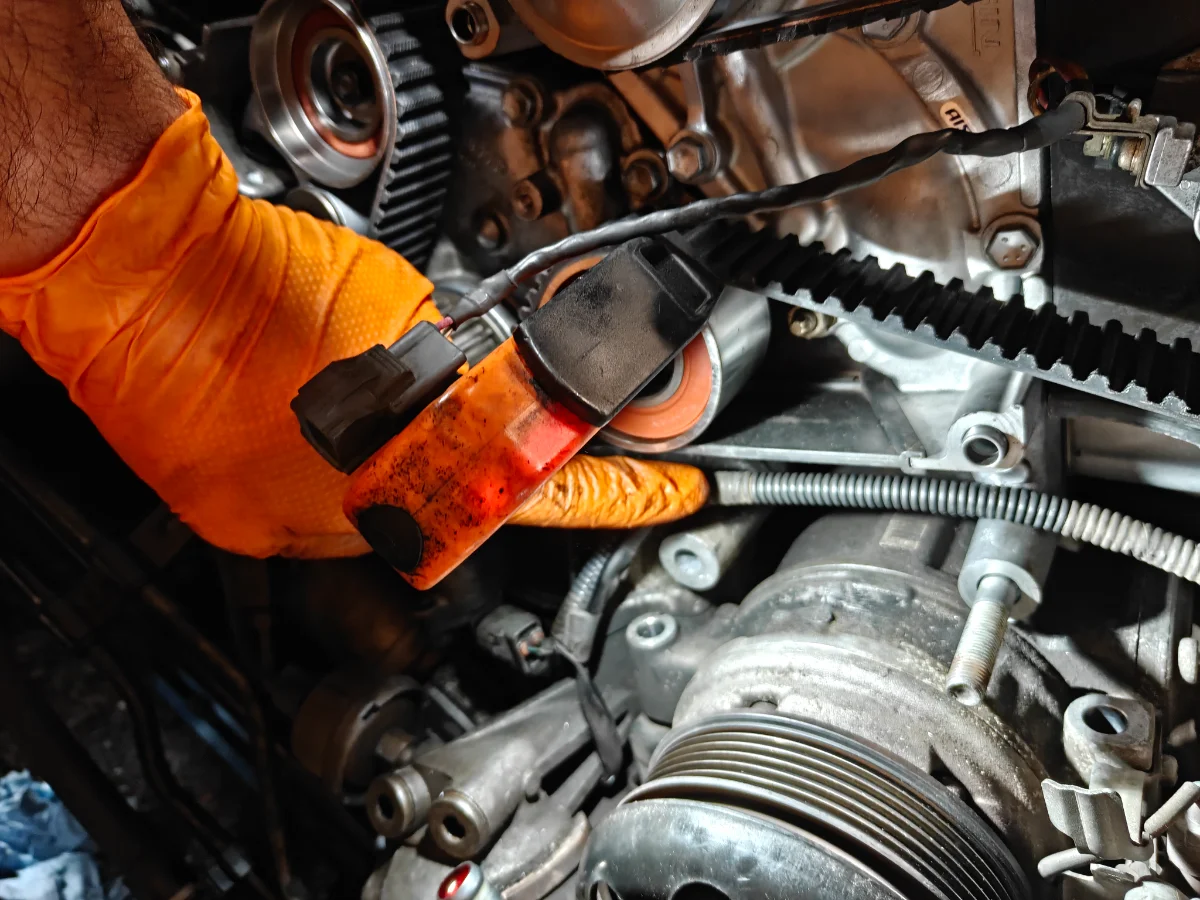

Just wanted to add something that came to mind while I was responding to someone else's thread earlier. Its not uncommon that someone does the timing belt on these 2UZ engines and routes the wiring harness on the wrong side of the fan pulley which can sometimes cause the crank sensor wiring harness to rub against the serpentine belt.
You crank sensor is to the left of my finger in this picture. That's the harness going up along side the A/C compression.

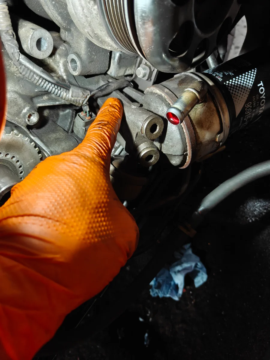

Its suppose to go UNDER the fan pulley bracket(bracket removed in picture below.)

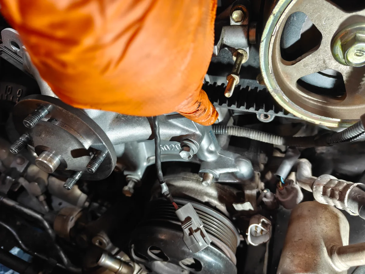

Then come out under the black plastic cam gear cover(fan bracket installed, no cam gear cover installed yet) and routes up across the face of the driver side black cam gear cover and along the driver side of the intake manifold. If yours harness is visible on top of the fan bracket, then it was routed wrong. If it is indeed routed wrong, ensure its not making contact with the serpentine belt and with the engine off, just check to see the harness is not under tension/strain as that could cause issues if the crank sensor wires have an open or short.
^ proper routing.
You can actually see the cam sensor to the left of the gold colored cam gear in the picture above but on yours, it will have the black plastic cover over it.
